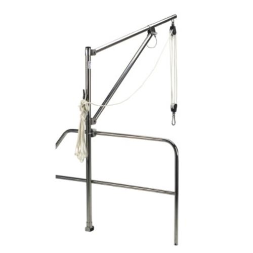

Is the Plastimo one of any interest ... I was thinking of trying to make something similar but smaller
http://www.cactusnav.com/plastimo-r...m-assembled-p-16931.html?cPath=1118_5430_5435

I'm going to see if the Plastimo one is on display at the boat show. If not, I think I am after something like Roger's, but smaller with the base at the deck, and the top part removable - which sounds like a custom job.
