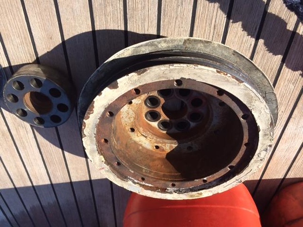

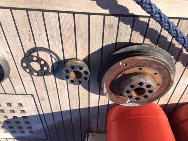

here is the pulley assembly
2 belts for the alternator, and 2 belts for the waterpump, and a timing scale inbetween

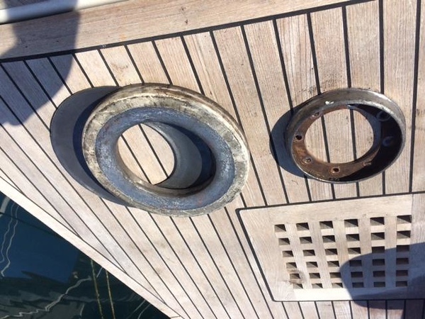

then the parts of the virbration damper were free to take off
so the cause of the disassembling was age / broken metal ring

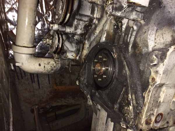

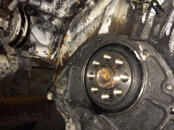

here you can see the fixing point on the cranc shaft,
the area around it is slightly damaged (not too bad)
some bolts of that cover plate were damaged,
one had be grinded to get it off
