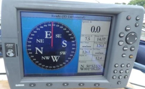

If this has been covered before my apologies. I have always navigated using charts, its about time I got up to date. After a long lay off from sailing I have decided to get another sailing boat, the one I am looking at has a chart plotter this one. I will be viewing the boat in the next few days. weather I buy the boat or not does not come into it, its me about me getting my backside into gear.
I think it is a Garmin 2010c, if I am wrong what make and model is it? I have used a chart plotter a couple of times in the past but a long time ago. I do not know if there are any charts loaded on to this plotter, if there is i do not know how old they would be. What I need to know is how to down load the charts for this plotter (would it be on to a SD card)? I am thinking of Navionics as it seems to be one of the most popular ones. I need someone to walk me through the process, I know I can down load a trial for a couple of weeks, that would be plenty of time for me to get the boat back to my home marina, but would you trust the free trial. I also have a new phone a Samsung Galaxy A15 5G that I think I would run Navionics as a back up. I have plenty of old charts to get me home, they are a bit old, only about twenty years out of date. The land does not change much, with No1 eyeball navigation and a reliable depth sounder. ? ;) I would have them with me. Boat south coast me east coast. So you knowledgeable lot educate me.

I think this is approaching 20 years old, so would not be surprised if chart cartridges or updates were no longer available. Garmin support seems to think anything much over 5 years old is not serviceable. If it works and if there are charts loaded, the rocky bits won't have changed that much. I'd buy a new paper chart and use a phone or tablet with up to date charting.

As I understand it - the 2010C plotter is not a factor to stop purchase of the boat - OP is asking advice on its use and whether still viable.
Simple answer is to look at the manual and also online Garmin site to see about compatibility ... Garmin are ar*****es when it comes to compatibility - they insist on taking a perfectly good product such as Navionics and altering it so you need Garmin version to run on Garmin gear ...
But lets see about this 2010C ... its old - but there is no reason why it should not function well ...
GPSMAP® 2010/2010C | Garmin Support
It uses BlueChart or Mapsource data cards ... not Navionics
Lets look at Garmins List of compatibles ....
Cartography – The 2010C features 2 built-in Micro card expansion slots for using Garmin’s BlueChart™ cartography. These charts provide integrated maps for a much smoother presentation.
Note: The 2010C uses BlueChart™ no base map. The 2210 uses BlueChart® g2 and comes preloaded with a basemap."

probably works (screen fires up it seems)
GPS antenna (separate item fitted somewhere on the boat) is probably working (if the pic posted is the one from the boat as it shows a fix). However it may still need a gps antenna change to show the right date for tides and such...
HOWEVER, the card with the map on it, is not the bog standard SDCARD you see on newer plotters but a fancy oblong thing that needs a special hardware reader/writer to upload a new(er) map to it.
Have done so 7-8yrs ago, wasn't easy, wasn't fun, not looking fwrd to doing it again.
So, if the map on it is recent (really cannot be unless someone spend lots of time picking a Bluechart from newer plotters and packaging it into this somehow) it's fine, else you just look at the rocks and coastline :)
wouldn't invest money on it, just replace it with a NMEA2000 device and sell that on on ebay!
