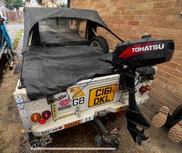

I had the outboard on the back of my Mehari (2cv based) and the Waitrose delivery chap earnestly asked “what is that car, does it go in the water”
