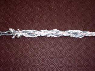

I have done a fair bit of splicing before, large eyes, to thimbles,in to chain and also with backsplices for moorings and anchor bridles/lines but always with 3 strand. I have just spliced some 12mm nylon octoplait into 8mm chain and even thought I have followed the splicing instructions exactly I am not happy that the result is right. Why I am saying that is when I tension the splice by pulling on the chain and rope there is a small movement right up to the end of the splice and it looks as if the end section where the 4 pairs ends are split and rejoined to a like twisted end and heat sealed is what is stopping it from just pulling through and I do not think would withstand anchoring tensions..
It looks right according to pictures of correctly made splice, it is done with 14 chain links but I am not convinced. I wonder whether 12mm into 8mm chain is just too small as each of the 4 pairs is only about 6mm of pretty loose fibres and passing through the chain links is quite loose even the 1st link where all 4 pairs pass through two pairs one way and two pairs the other way.
Any ideas on this. I suppose I could redo the splice and backsplice from what woiuld normally be the end back towards the rope although I have never seen that done but should work?

Maxwell seem to suggesting 14/16mm rope for 8mm chain.
Look at the thread on chain piling up - Thinwater has suggestions on chain to rope splices - though I don't recall he mentions sizes. He might be along later - he's done a lot of work in this area for Practical Sailor. However note that a 5/16th" link, he's from the Chesapeake, though it is nominally 8mm is a bigger link and may need even bigger cordage.

I think from the link for rope/chain sizing I should have used 14mm for 8mm chain-doh. Better to learn from others mistakes than insist on making your own. A backsplice on chain it is-I may patent it when I have worked out how to do it!

TW - any ideas on the difference in breaking strength between the long splice rope-to-chain and the back splice round just one link, please ?
The latter looks like a candidate for hardening under load, and doesn't appear to share the load along the plait.

The one-link splice is recommended by most windlass manufacturers and is 100% strength. As for compatibility with any specific windlass, I have found some windlasses like one, and some like the other. I'm sure it also depends on the rope. It is also helpful to make the splice rather loose, not snugging aggressive but using more passes.
The best of all worlds would be a variation of the irony splice in plaited rope. I'm sure it is doable, just a little tedious to perfect.
* pull 2 strands out way back.
* make the 1-link splice with 6 strands each way. Stagger the endings.
* work the 2 strands back in, trimming at staggered lengths.
