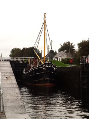

You may want to contact the Caledonian Canal and discuss your plans. As a child I lived near the Corpach Basin and there is no way I'd want to be in a lock in a wee boat while it was filled or emptied. Two police divers were killed diving on a lock with a full diving team!
Portage round Neptune's Staircase would be a interesting endurance test.

I have seen small boats including Wayfarer in the canal, so suspect Enterprise wouldn’t be an issue if insured and crew with lifejackets on. Lock keepers adjust flow to suit boats - and skills (?) of crews, such as in rental boats. And going uphill always less turbulent at back of lock. Seen a jet ski go through one of the canals last year, can’t remember which one.
Transiting Loch Ness in any breeze would be more of an issue. Or indeed the centreboard case issue noted above.

In the canal or in the locks? Particularly thinking of Neptune's Staircase at Banavie.
We all have our own risk assessment.
The Canal are no strangers to dinghies going through as Dunedin says - either with an entire lock full of dinghies or I’ve seen a dinghy lashed alongside a friendly yacht. You may be easier pulling through the locks with some really long rope than rowing.
On top of what’s been said - you’ll need to think about where/how you mount the rowlocks and storage of the oars when you are not rowing. Canal needs fenders too - so storage starts to become a premium.
