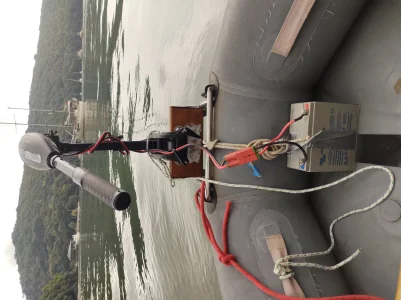

We do pretty much this. Except we're still running a 25Ah agm. We have 2 x 50W rigid panels in parallel, compressor fridge, wind gen all into a single 110Ah (could do with a little bit more generation and battery TBH, but we're only just short if it's cloudy etc) but we cruise fully ofc grid ok. So your 4 panels plus bigger batteries will be a big leap. FWIW, I bought the little battery to see what it would do - it had to get us ashore and back say at East Head or Newtown and it does that easily (but not quickly - quicker than rowing though 😁). When this one dies, I'll look at lithium, but this is working for us ATM. AFAIC, it's all very well having a Torqeedo and bombing around like Crockett and Tubbs, but you've got to find that energy from somewhere when you get back - and it's not going to be shore power for us, so we go leisurely instead 😄
And I've just taken delivery of a Victron smartshunt so I can (a) monitor the battery in real time (b) see how much we need to put back in and (c) monitor overall use over time and as part of the boat's energy budget - which is why I paid extra for Victron
