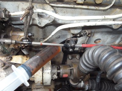

I did exactly this; I McGyvered a large syringe (60 ml) with some thin hose and some pipe fittings and was able to effortlessly inject two full syringes of oil. Partly because I thought there might be a blockage in the pressure port (I have no idea how small the actual hole in the engine block is), and partly in the hope it would help prime the pump. The 120 ml I injected made no difference at all, but I suspect it's not nearly enough to prime the pump. Problem is I only have 10 L of new oil, and if I use too much trying to prime the pump with the old oil still in the engine I won't have enough to fill the sump afterwards, which I think takes 9.6 L.

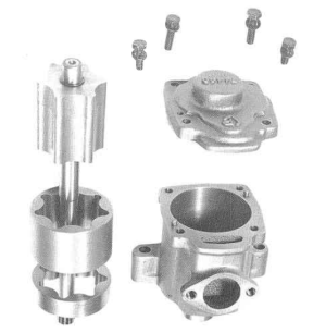

Old oil is black, but it's still definitely oil. Having looked at the pump in the workshop manual I can't see any way that beast could possibly have just stopped working. It looks virtually indestructible - other than through long-term wear.
