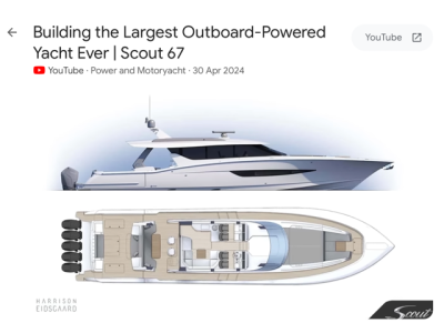

The OP doesn't say what type, or even size, of boat he's looking for. But given it is twin engines and there are shaft drive and stern drive alternatives, it's probably safe to guess at 35ft - 45ft.
Would those advocating outboard engines really want a circa 40ft outboard boat in the UK?
