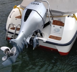

I have an AMT 200 cuddy with a 150 VTEC outboard.
It's freshwater flushed after every trip, the leg is full out of the water with only a third of the transom bracket in the water.
It stays afloat 364.5 days a year.
On the half day it's pulled out on the trailer for a leg oil and engine oil change.
I don't change the impeller annually either as I have sufficient data coming from the engine to determine if it's failing.
Fuel filter is inspected and emptied to check if water ingress but not necessarily replaced annually.
My point is that modern outboards are cheap to service and fuel efficient and are certainly becoming much more popular.

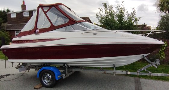

Having said all that, I've just bought a Maxim 1700 sports cuddy with a 100 Yamaha 4 stroke on a trailer for £8,300 on behalf of my brother and whilst it needs some fettling it's a great first sea boat for him.
The AMT200 looks like a really nice boat, especially with the ouboard - it sounds perfect for the way you are going to be using it. £8,300 for a 100 HP Yamaha is a bargain- especially if they threw in a trailer and a Maxum - now all he needs to do is find a better hull to put that engine on.
