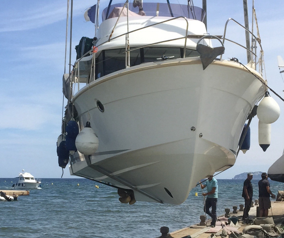

Jamie, before you come to Conwy could you straighten up your anchor please.
Had boats in Conwy for 3 years, was a member of NWCC and had a mooring in the river. Done that, been there, see no reason to go back. I doubt there is anyone I know there now.
