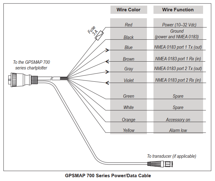

Any idea how to make NMEA 0183 output (TX) from Clipper Wind +Repeater to Garmin GPSMAP 700? In spec they claim Clipper Wind has 'NMEA 0183 output - MWV string', but no info about cable colors or how to make such connection.

Garmin GPSMAP 700 has 2 NMEA 0183 port. There is possibility to set standard 4800 baud rate or high speed 38400 baud rate on both. Also I can connect it to Camino-108 AIS with 2 ports.

Without any more information I would choose the first one as this is specific for the mk1 five wire unit. It only has two wires so you have a 50% chance of connecting it right first time. I would simply trial connecting this to either brown port 1 or violet port 2 and black on the Garmin cable.
If it doesn't work first time round try swapping connections. I have never caused a single component failure by doing this In all the time I have played with serial or nmea connections. I very much doubt the comms set up will be at anything other than 4800 baud.
