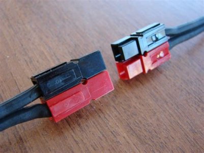

The solar panel is on a flying lead, so I need to be able to connect and disconnect fairly quickly, down next to the batteries. I had seen something with round pins and sockets, but the Anderson Powerpole looks better.

I'm not sure what an Anderson Power Pole is (I'll look it up later) but you can source water proof Andersons and sealed housing for Andersons used for caravans and 4x4s (so maybe Halfords or caravan shops). My solars have been supplied with 'normal' Andersons. I have extended cables and use solder for the Andersons rather than crimping, as suggested by someone in my thread, see earlier post. A cheap source for Andersons is Temu.
