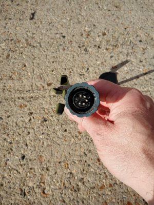

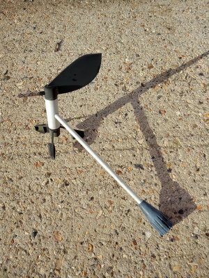

Having just dropped my mast, I found the reason the anemometer had never worked was because it was... well, not as supplied by the manufacturer.
Anyway, I would like to replace it, like for like if at all possible or at least one that will fit the same connector. Can anyone help identify what make/model this is please?

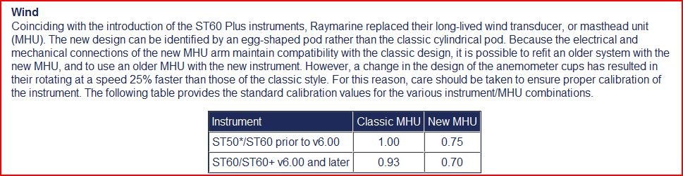

As said above, the Raymarine ST60 transducer, (eggshaped) will drive the ST50 display but, from distant memory, I think that the windspeed readout will be too fast, and a factor of 0.7 is involved. I can't remember if the ST50 display can apply that correction. The info. might be on the Raymarine FAQ website, sorry I'm not more specific.
Edit; here's a table I've just found that I saved some time ago.

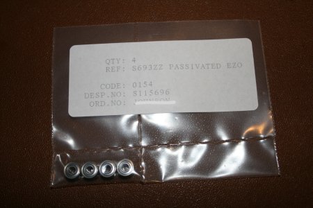

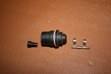

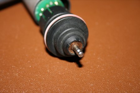

I was also going to say that if you're handy with a bit of DIY then the bearings can be replaced..
A few photos from when I replaced many many years ago..
The plastic was just crimped over the top..
The bearings all slid off the shaft..
And these are what I'd ordered (although double check)..
