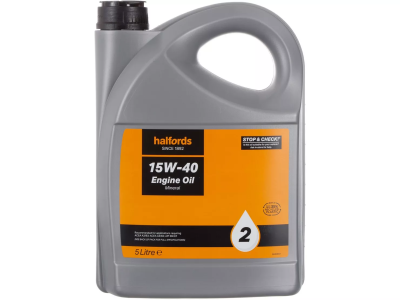

If you just want straight mineral oil Halfords no 2 is just that.
I dunno what this means:
IF as my AI has it ""Halfords number 2 oil" typically refers to their 15W/40 N2 part-synthetic engine oil" (and in this case its guess is as good as mine) then that couldn't reasonably be described as "straight mineral oil"
That term often describes a "straight weight" (i.e. not multigrade) oil. Though very unfashionable, there are reasons to like these, and I used one (China Petroleum Corporation SAE 40) in cars and motorcycles in Taiwan.
In miserably cold UK, not so much, and I very much doubt you will find any in Halfords

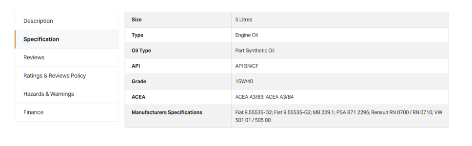

Yes, it is interesting that the Halfords N2 says "Mineral" on the can, but the spec sheet says "part synthetic"
However, the spec looks OK for older engines, even though it does not specifically mention Volvo VDS.

Just says mineral oil on the actual container.
Actually the website seems to say that as well, so AI is perhaps gratuitously making stuff up again.
EDIT: As per above post, its presumably accessing the spec. sheet
