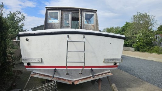

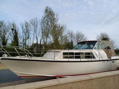

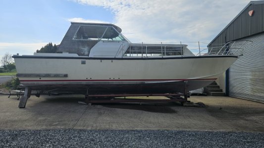

Hi, i have recently got myself a rather large project in the form of a Moonraker 36. it has been completly gutted out for a refit that unfortunatly the owner passsed away.
not sure how i am going to tackle the project but it will be over a good period of time..
what advice would anyone give on what equiptment i should be putting in it, im guessing i should be renewing as much as i can in way of electrics, controls etc. what are the must haves etc that i need to get.
also any ideas on cabin layout and finish? i will try attach a few pictures if i can.
i imagine the boat will mainly be on inland waterways unless i maybe take a mad notion and head to France for a holiday.
All help appreciated
Also what model is this one?
Thanks
Jim

Hi Jim
It looks like one of the early models without the flybridge, what engines are in her?
With a T then it is either a 145hp or 175hp very unlikely to be the 240hp
You can check the serial numbers and it will give you a clue, the starboard engine "may" be running in reverse direction, if there is an X in the serial number then it is a reverse engine. I have a 1978 Ocean 37 with HT6.354 engines of 145hp and the starboard engine rotates in the opposite direction. Spares for it are a little bit more difficult to come by. The "H" in mine means it is a horizontal engine.
My father's 1972 Moonraker 36 "Softrider" without flybridge had the 145hp Perkins. I think all the 175 equipped ones had "350" in large graphics on the side air intake panels. The version with no rear cabin is probably quite rare.

Congratulations you have a rare boat and a lot of work ahead of you !😊
You should be ok for engine parts availability as they will be ‘normal’ upright Perkins….engine serial numbers should give you the hp with a bit of Googling or ask on here…..
If you put into google Moonraker 36 aft cockpit there is a couple that have been for sale so you can take a look at the original layout for ideas…..

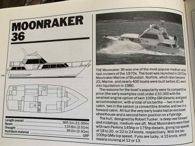

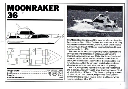

IBSN. 1-84280-076-0
The turbulent history of JCL. Definately worth getting copy...................
