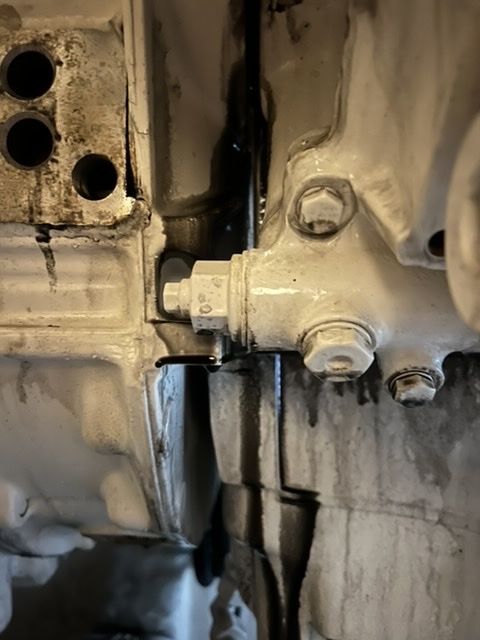

What is that a photo of?
A place in between the twin oil filters assembly (on the right) and the timing box (on the left).
Below is the right way to look at it, but you don't stand a snowball's chance in hell to understand the position, unless you're familiar with this engine.
Which, while I'm far from pretending to be as knowledgeable as a MAN engineer, I can say to be to some extent, because that's what powers also my boat.
In fact, Chris, I'm wondering if you are positive about the leak coming from the filters assembly: did you ask a MAN guy an appraisal?
Based just on your pic, it rather looks like the oil came from the joint between the engine block and the timing box.
Which is right in between the block and the gearbox, and BTW is known to be a possible leaking point.
I'm not wishing you this of course, but if that would be the case, I'm afraid it is indeed an engine out job - even if just for replacing a silly and cheap (well, relatively, as always!) seal... :oops:
It’s not the filters, it’s the block that the filters are bolted on to, I’ve had a very good MAN engineer with his head down there and seen the oil leaking, very common problem, the engineer said I should change them both, even if they are not leaking yet.
