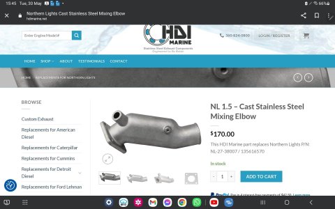

Mine is a cast s/s elbow. No welds. Perfect after 5 years. It has been used for approximately 1200 starts and stops of the engine over that period as its a generator. Mine was supplied as a Northern Lights generator part. I bought whilst we were in West Palm Beach, Florida. Its nicely made and wasn't expensive. About $180 US at the time

This is what I fitted. The discharge direction of the exhaust was slightly different but it caused no problems received_245187888117783.jpeg
