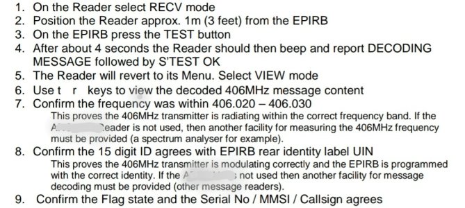

The testing that is done when returned for battery replacement and test is in a different league to what the end user can do with a simple 'self test'.
Their test equipment will measure frequency of the transmitted signal, and that the transmitted ID is correct and readable (as below)..
A self test will not discover those faults.
Whilst talking about testing... how many do actually self test... and how many test that their AIS/DSC devices transmit correctly.. That's for another thread.
Is it being suggested here that when a device self tests, and it passes, that actually it's quite possible that it isn't functioning within spec?
