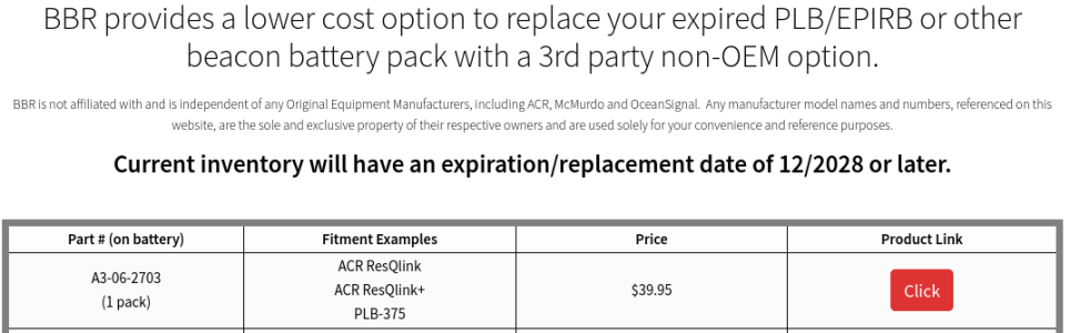

This is an interesting subject.
I've an ACR 375, which is OK for me. I've just done a self test on the device, and it's happy with itself.
To replace the battery is a matter of unscrewing 2 screws, separating the case, unplugging the battery, plugging in a new one and resealing in the reverse of the opening procedure.
5 minutes? Maybe less.
Online quotes for battery replacement are about £130+p&p., which does include the very well documented self test, that I've just done in under a minute.
I've not found the battery in the UK yet, there's a straight swap with one from the USA for under £40, but as my boat's coming out of the water soon, if I'd needed a replacement I'd have been able to remove the 'old' one, inspect it and get the model number from it and source it from that.
£130+p&p??

I disagree.
The self test will be every bit as rigorous as the itemised test in the factory. It won't itemise a fault, it will simply fail the item as there's a fault. The £130 battery replacement wasn't a factory job, just 'yottie' places.
I believe that ACR no longer service the PLB-375.
The ACR battery is cited for replacement after 5 years.
The life from this USA supplier is also 5 years.Screenshot 2023-07-30 15.19.29.png
