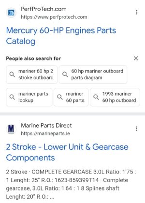

Hi, finally managed to get the screws out ok, bit of heat and the impact driver, the left hand one is definitely the vent/fill for the gearcase, the right hand one I can't figure out at all. Its exactly the same screw, but behind it is just a void, all that's there seems to be the gearshift rod. Very odd. Doesn't seem to have a purpose but it must be there for something... The parts diagram (thanks Bill) doesn't show it, but strangely enough the parts list specifies 3 number, so all very confusing.Can't find my manual maybe I gave it to someone...but these people list parts and maybe identification...
