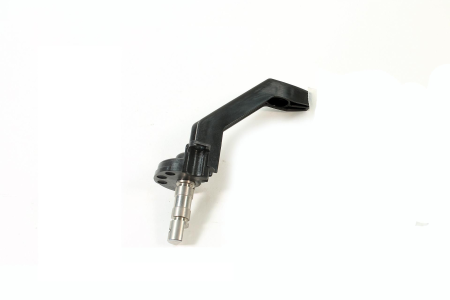

I have in many respects the perfect OB for my tender. The Mariner 5hp 2 stroke. Its light weight, the remote fuel tank means it doesn’t leak petrol over the boot every Friday and Sunday evenings and has ample ooomph for me.
Many years good service it’s offered ‘til last season.
The issue I have is the gear lever to select F/N/R is stiff and now seized solid. The gear box is fine, the issue is the plastic gear lever itself. This plastic lever passes through a metal moulded in bracket in the casing without a grease point. Last season the swelling of the plastic lever got too much for the casing and its siezed solid.
I had a go at removing it to no avail and I have dropped it off with an outboard service mechanic who’s not had much luck either getting it free / out let alone sourcing a replacement.
It feels incongruous to chuck out an otherwise running great outboard for the sake of a bit of plastic.
Any ideas of how I could fix myself / heath robinson a solution to keep it running for a few more years?
Thanks

Is it possible to drip vinegar onto the shaft from the other side of the shaft? If used in salt water, there could be dried up salt crud in there and vinegar should start to dissolve it.

I had this issue with a tohatsu 3.5. Was fixable fairly easily as there is a removable plate to get to the inside of it allowing it to be levered out without destroying it, clean up, put back and now it moves without any effort.
Now i have a 4t suzuki 6 with the same problem. Unfortunately this time round the whole power head needs removing to gain access to attempt repair.
I poured and sprayed all sorts over it but it still won't budge.
What i have learnt is if one's gear lever is starting to feel a little stiff, sort it out before it seizes up solid.

I did a similar repair to a Honda 5HP. It seemed to be a well known problem with the Honda, the plastic bushes swell and the gear change shaft becomes stiff.
The repair for the Honda is well documented, lift the power head out of the leg then remove the pan to give access to the gear change shaft. remove it, ream out the plastic bushes, re assemble with lots of grease and re assemble.
Expect to be repeating in a few years.......

I'm not so sure it's the plastic causing the problems. It's more that the aluminium oxidises and expands, crushing the plastic and eventually seizes everything up.

Hi I have experienced the same problem.
I found plenty of patience and liberal amounts of plus gas eventually paid dividends.
Careful manipulation of the lever Backwards and forwards to avoid it shearing off.
Taking the powerhead off will be necessary to get good access. These are great engines worth hanging onto.

I think it's a plastic shaft in ally, so good chance of parting it off. No amount of unguents helped with mine. You may need a gasket for the power head if removed, I didn't bother. Only thing is, although I have done it many times, I could not get the water pipe back in the pump last time, had to drill a hole in the leg and put a bung in it.
