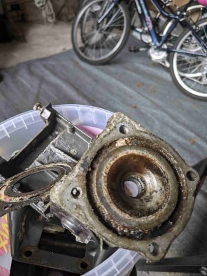

Hi all.
So to follow up, I've started to take the engine apart this weekend.
Having sprayed penetrating Oil in the cylinder all week, it's no longer seized and the piston is now moving pretty freely.
The spark plug will need changing as it's seen far better days!
I took the head off also. There was a lot of salt and mess in what I think is called the water jacket? i.e the gap surrounding the cylinder?
I've scraped a lot out but I'm not sure if I'm supposed to drop in some white vinegar?
I will also need a new head gasket and will also blast the carb with carb cleaner.
Other than this, is there anything else I will need to do as standard? I'll change over the gearbox oil of course, but wondering if I'm missing anything else?
Next weekend I'll reassemble, I keep my fingers crossed that it fires!

Hi. Great job.
Can I just mention that you should really take the carb off completely and then clean it thoroughly. Or at least avoid spraying carb cleaner in it when it’s still in place. You’ll take the paint right off the engine power head !
Thanks and yes, the carb is currently sat on the kitchen table waiting for me to get my behind in gear!
Thanka
If you have some glass or a piece of very flat laminated board, stick some wet and dry to it and sand/clean the head and block mating surfaces.
