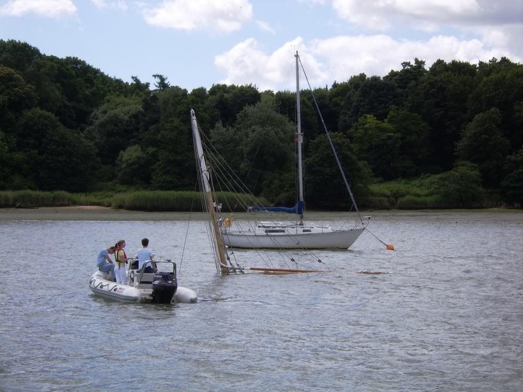

Speaking from experience-see attached photo.
http://i201.photobucket.com/albums/aa201/willfinch36/STA78008.jpg
Be very wary of through hull fittings-this is after 8 years afloat -supposed to be bronze. Now replaced with a Blakes 3/4 intake with 4 bolts. The blakes fitting needed to be need packed out. Simple solution is to sleeve the 3/4 blakes fitting with a piece of old hose- no need to mess abour with unnecessary woodwork. Assuming you have a good pad in the inside.
Regarding ball valves- I saw one last week that fell apart just where the ball seating is crimped in. betwen the hex part and the ball-There was surprisingly a small amount of material there. It was fitted in very expensive yacht in Ipswich. It fell apart when droped on the ground.
What about this idea? Cast a skin fitting out of bronze with a grid on the outside,make the walll thickness 3 to 3.5mm(common) thick THEN cut a BSP thread 2.2mm deep- does'nt take much to work out the thickness left!!!!! I wont use one again.
Check them regularly.

Sounds like a Tonval or brass skin fitting. Google Tonval and there is a test case where a boat sank after a year or so with a Tonval fitting.It was, if I remeber correctly, slightly overtightened, and quickly failed.
Most chandlers only stock these, but often refer to them as bronze. Likewise the ball valves that are chrome finished are usually brass too.
Proper bronze skin fittings and ball valves are available, they are not much more expensive, and I get them from Seaware in Penryn. Most chandlers mistakenly think Tonval is 'bronze', and okay for below w/l use.
You will find chromed brass ball valves on most 'most expensive' yachts!
