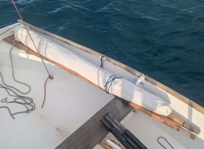

Update: finally dragged the sewing machine out of storage and set it up. I've never used one before so it was a bit of a learning curve.
But, voila, I now have a pretty serviceable sail cover. Not a thing of beauty but it does exactly what I need.
I feel more projects coming on, it was very satisfying 🙂PXL_20250317_112254003.jpg
