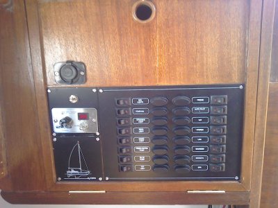

I need a small amount of thin mahogany (or similar colour/grain) veneer 3-4mm thick and about 200mm x 120mm. Also some (solid) trim to go around it to fill a hole where an old radio was removed. Have googled extensively but cannot find anywhere that supplies this. Any help appreciated,

Unless you are refacing the whole panel you will never hide it… have you considered fitting a cubby or glove box to the whole?
