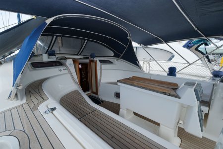

What furling/stowage arrangements have you got for the mainsail? Can’t quite see from the pix.
Roller furling with continuous line to a powered winch by the companionway. I think it has vertical battens but I need to confirm that .... if it doesn't, it will have soon. Looks like I can reef the main and the genoa from left of the companionway ... the buttons for the electric genoa furling (red & green) are next to the button for the cabin-top winch which furls the main.
PS: That pin through the anchor shank has got to go, as has the anchor.
