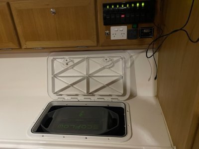

The units are placed in under settee berth locations in both the yacht and camper with in the yacht location being fitted neatly into hatches with attached plastic boxes keeping them out of moistures way.

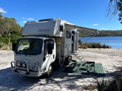

Remote free camping with just our Isuzu NLS AWD car licensed truck with Beyond slide on camper with remote controlled electric jack off legs. We generally leave it on for most camping applications but it’s 10 minutes to take it off and 15 to remount it freeing the truck for other uses.

Also the fitment of our EcoFlow lithium Delta Max 2 power packs into proprietary hatches with attached plastic boxes under our settee berths on both sides of the yacht is a very neat solution keeping them out of harms way even if our yacht was leaned way over and if there was ever water in the bilges. ( we have a very dry boat )
The closed lid just pinched down on the top slightly completely securing them and at 23 kgs. I think that’s pretty good for a completely plug in and carry away portable units featuring a just over 2000wh lithium battery, 2400w with 3000w boost and 4800w spike capability sine wave 240v inverter, an MPPT solar charge controller and a computer controlled super fast charger with remote control switching and monitoring of both input and output by phone app. The monitoring has taught me a lot about solar panel performance and adjustment and individual appliance power usage as well. 🙂
