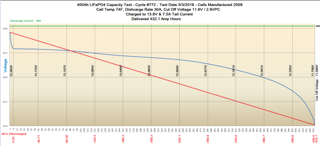

He has a website (Marine How To) but I found the following on the Facebook group 'lithium batteries on boats' (info on cycle life and degradation is at the end):
Happy 13th birthday to my LiFePo4 battery bank(5/10/2009)!
Back in 2007 the first lithium iron phosphate battery cells were just beginning to be manufactured and become commercially available. I dove in & began researching everything I could about lithium iron phosphate. Unfortunately back then there was scant white papers and scant research available. Anything that was available was behind a pay-wall at some university. I decided if I wanted to learn about lithium iron phosphate I needed to buy some cells & start experimenting. That was the only way I was going to learn. My first cells were small 100 Ah thundersky cells because they were relatively inexpensive and I didn't really care if I ruined them. being this early into a new technology I knew I was going to get some arrows in my back being a pioneer.This was all before cylindrical LiFepo4 cells even existed.it would've been much easier to destroy a few $10 cylindrical cells than cells the cost me $200 a piece.
I wound up destroying those initial cells pretty quickly experimenting with charge voltages, how deeply you could cycle them & such. I quickly found out that they didn't really care how deeply you discharged them other than going below about 3.00 VPC. I quickly learned that the cells did not need to charge to anywhere near 3.65 V to attain 100% state of charge. I also learned that they did not like to be absorbed for longer than is absolutely necessary. On those early cells these batteries were quickly degraded if you left them on absorb for too long a duration. After all this testing and experimenting I finally decided to order a set of 400 amp hour Winston cells for my own vesel. It may sound hard to believe, that back in 2009 we had a lot more availability in battery management systems. Genasun was actually building a BMS Clean Power Auto had one and there are a number of others mostly designed for EV use but that can be modified for marine use . Other than Genasun the only BMS that was specifically designed for marine application was made by a company called Clean Power Auto. Demetri the owner of that company is now is the engineer at Lithionics.for perhaps 2000 cycles I use this clean power auto BMS. At that point I switched to a REC BMS.
For my own banks charging I decided on 13.8V @ roughly a .4C charge rate with a 30 minute absorption and no float. The primary charge source for this bank has been the alternator and a Balmar MC 614 regulator. While we had plenty of solar solar it remained off most of the time. We used this bank with just 30 minutes of engine runtime a day. This is pretty easy in Maine with the light winds we have in the summer. Doing all the charging from the alternator worked out perfectly. If we needed to stay at anchor for more than three days I would simply flip on the solar array just to slow the discharge. The original charge regime I set up for this bank back in 2009 has worked amazingly well. Today the battery has over 2300 cycles on it with almost every cycle going to at least 80% depth of discharge purposely. As of the last discharge capacity test the bank could still deliver the full 400 amp hours of capacity (Technically a little bit over). So, for those who say LiFePo4 hasn't been around long enough to see how long it actually lasts, I'd say 13 years & 2300+ cycles is pretty good data so I am personally sold.😜

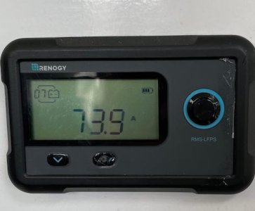

So this was taken at 9 am today in the UK with hazy cloud . 74 amps going in to the smart lithium batteries from solar (actually more but this is the net input whilst its powering our computers, fridge, freezer and so on aboard)
I have 700 ah of batteries and 2155 watts of solar panels - set up optimally with 4 MPPT and a combination of series and parallel
We have no gas and run a 3kw inverter, with a full size 240v fridge and a separate full size freezer, we have two hot water tanks with 800w elements and run all boat systems plus two Macs, Starlink, TV, PS4 etc. All lights are LED. We cook with an induction hob, a 2kw combo oven/grill/ microwave and an air fryer.
In UK / France in several years we have had to only use our DCDC chargers from the 125amp alternators two or three times for perhaps an hour . So in daily use from April to October over perhaps 1000 days with this set up we have needed only about 4kw extra power from the engines - and that is more preference than necessity because I have never let the LifePo go below 50% I should add my old water maker only took 20 amps DC for an hour a day - my new AC one is 65 amps but makes more than twice the amount of water which I'd love to say will mean we run it less but will probably mean we just sue more.
From November to April we run a shore power charger on days when its cloudy or in mid winter when its just too short a day in the UK but that includes most days a dehumidifier up to 24/7 which draws up to 5kw per day . Our electricity bill for winter has hit about 1200 kw (£400 at 33p / kw)
We could not at this stage run a UK winter without shore power (and thankfully will be in sunny climes in about 2 weeks) but by using the solar, lithium and inverter with the shore power just to top up the batteries via a charger we minimise shore power use.
Hopefully this helps the OP somewhat - I've not logged KW used and Kw generated etc because I have a life but over 5 years now I have lived aboard almost full time and whilst I am quite careful about usage - as in I will turn off hot water whilst I cook and then turn it back on again rather than draw 3-4kw all at once and that kind of thing - my only tinkering was to add an extra 500w of panels at one stage and 200 ah extra batteries from my initial estimate after a year. If I were staying at these latitudes I would add maybe 200ah more (total 900) and perhaps 2 more panels to try and be independent through winters but in the tropics I will never worry.
Ultimately in real terms now solar is direct cheap and lithium is not too bad either so put on as much as you can and you'll be fine through several days of cloud. Bear in mind even with which grey cloud (if not active heavy rain) we still add about 20 amps an hour and in white cloud up to 45 amps so there is always some more going in
