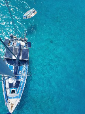

We've got about 1200w total on a 39ft mono. The foredeck panels go in to storage for serious passages.
Looks pretty tidy, we're thinking of a similar arch for our 36' instead of a bimini as I like the idea of shade and think the alternative is a full hobo looking boat with panels everywhere :ROFLMAO: Unless, of course, we can actually find a 45 footer that's for sale and doesn't need major work! None we could find in the last year though :(
Sea Change - Thanks for the effort to offer the picture. You have excelled in offering detail.
As I mentioned the commonest comment is the difficulty of committing to a solar display that is big enough. It will be interesting to see how others addressed the problem.
We needed to add a bimini so it seemed to make sense to combine this with the solar panels. I don't think there's much difference in price per m² between solar panels and Sunbrella.
Waterproofing was a bit of a conundrum. I ended up finding some lengths of twinwall polycarbonate in a marina skip, and I cut these to a T profile to fit the gaps between the panels, then sikaflexed them in place. They started to lift after a couple of years but overall it's worked well and I can't think of a better solution.
The obvious downside to a fixed solar bimini is that it restricts access to the boom. But if you fold down the sprayhood you can reach everything. It also restricts visibility of the main, but no more than a conventional bimini. I have a perspex window in it, which helps.
The other concern is windage. The boat is currently on the hard on the Caribbean, so I took the precaution of dismantling the bimini for the summer while we're away. The frame is still up but the big panels are lashed on deck and the smaller ones went in the cabin.
