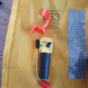

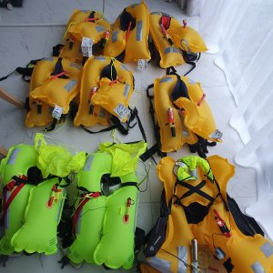

6 cylinders untarnished and each weighting the same .139 g
2 x clips totally vanished
1 x L/J scrapped and new a Auto L/J required.
Ordering 6 new capsules and 2 clips.
Please tell me the " capsule" fittings are universal and not unique to each L/J manufacturer.1738014549052.png🤞
I did say that that buying a few spare clips is worthwhile because they can come in handy..
If your capsules look the same, then fingers crossed the new ones will be good..
The dinghy pump can be used to inflate them (if you don't have a balloon pump on board!).
I should have said, perhaps check and order new lights whilst you're ordering stuff..

The capsules in post #1 are UML, as are the ones in posts #3 and 4, so they fit. You can order the green clips separately, there are two versions, dependant on date of manufacturer, detail on the website linked to.
Interesting to discover Crewsaver now tape the CO2 cylinder to a plastic protector, presumably to alleviate possibility of twisting and fracture of the threaded part of the trigger module.
I needed to cut the tape to weigh the bottles.
Since I haven't seen rearming kits with the stickers yet, I used a piece of electrical tape but concerned this might go gooey in warm weather.

I was able to carefully undo the tape on mine and re-use it.
