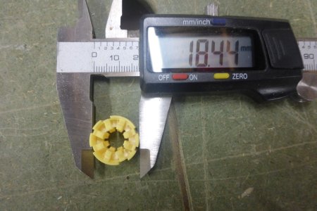

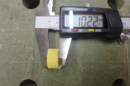

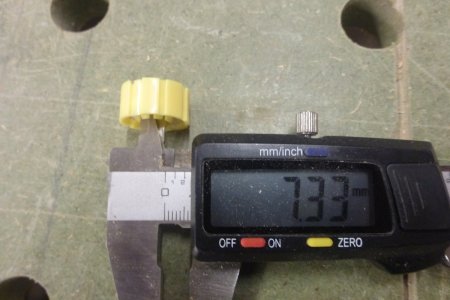

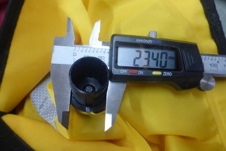

I've checked all my life lifejackets and they all tested ok. But I did inflate the only manual one - inflated ok and ordered new bits for the auto lifejackets - all turned up by next day delivery either Halkey Roberts or UML bits but when I checked the manual one I had tested it was marked HENCO. So the extra green clips I'd ordered didn't fit - I had not heard of Henco before... I might just scrap it as quite old.
Grahams376 pics show the bits for a Halkey Roberts firing mechanism - they look like the one I have on a junior lifejacket.
