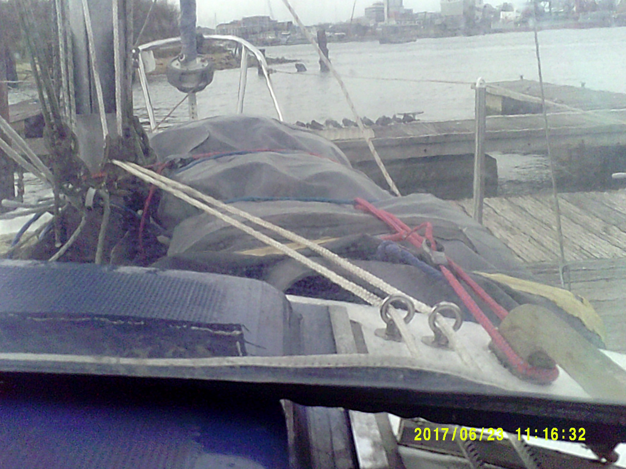

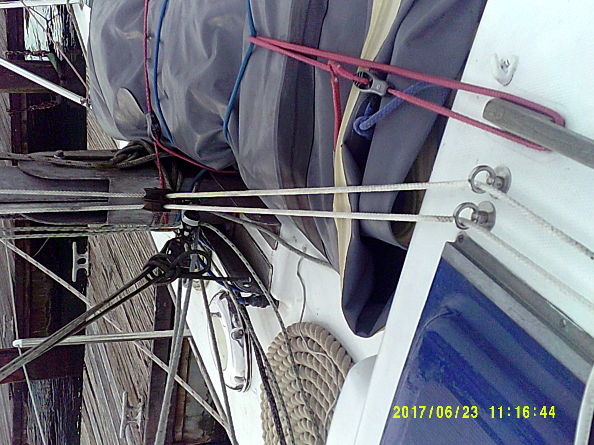

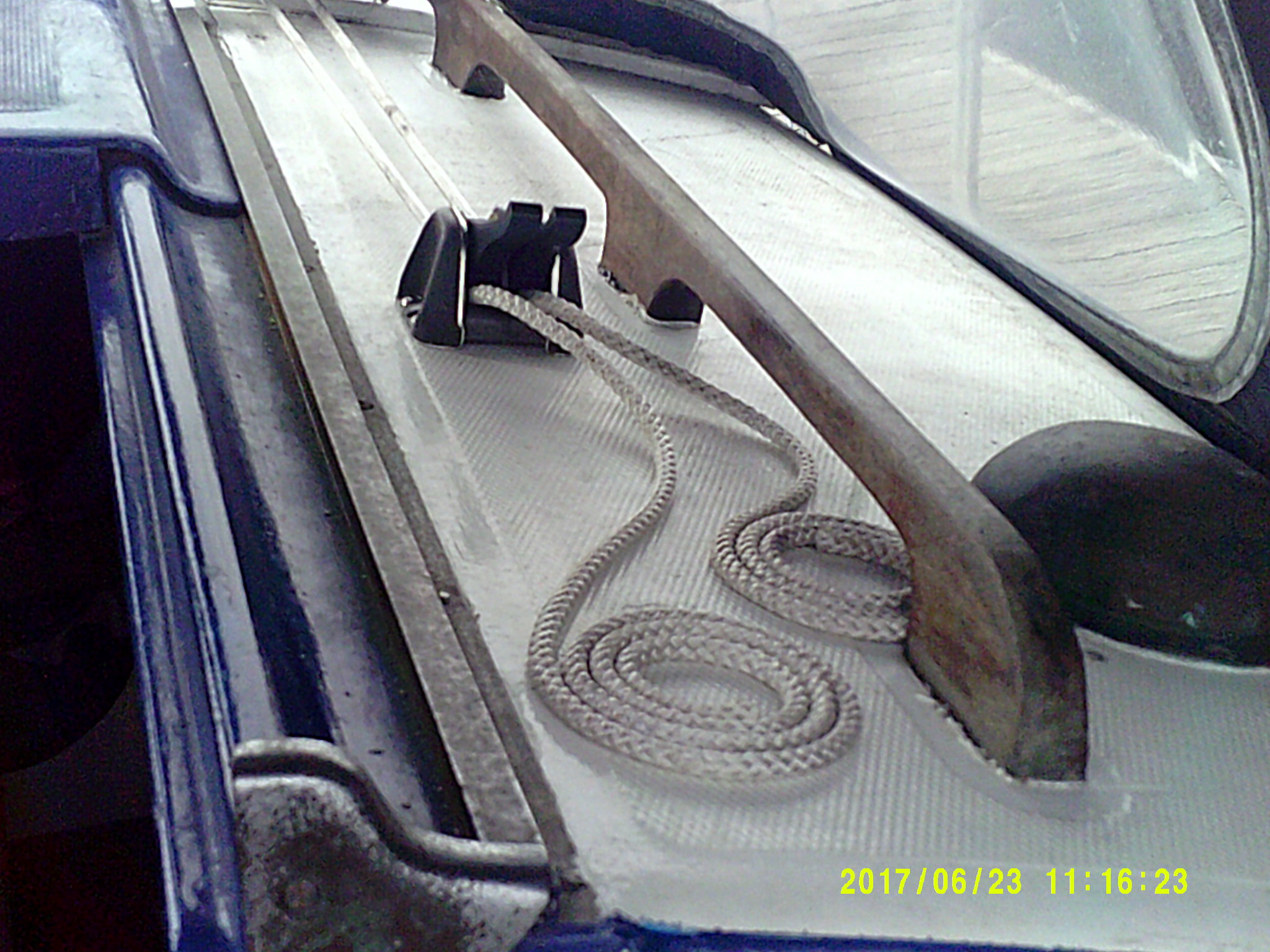

well proper inboard engines are new to us and a lovely luxxury, but not being able to get the sail stright up was a bugbear. I took on board the suggestions on here, and today fitted a couple of blocks, and ran the jacklines back to a couple of cam cleats on the coachroof. Works a treat, dropping them to hoist. I still have to fit it all properly, needs an organiser block to take the lines back properly

Those lines do look thick. I use nylon sash window cord. Braided, cheap, effective & thick enough
I think it is sash cord size by the looks of it, same diameter, looks about 8mm, I didnt fit it, I merely utilised what was there running the lazyjacks already fitted by the rigger. Fortunately it was long enough to reach the cockpit. ;)

Dropping the lazyjacks till the sailbag sides drooped, and heading roughly into the wind has done the trick every time so far. The battens occasionally still just about catch, but a flick of the sail or rudder sorts it out fine. Once the main is up we take up a little slack but leave them baggy until needed at end of play.
The other problems we had hoisting the mainsail were due to a badly routed main halyard catching, and reefing line tangles (they also go back to cockpit) which I have now sorted out properly.
So, in short, we brought the lazyjack lines back to the cockpit, added a couple of clutches to enable easy adjustment. It was enough with heading into the wind to make life easy.
So lazyjacks are not such hard work now.
