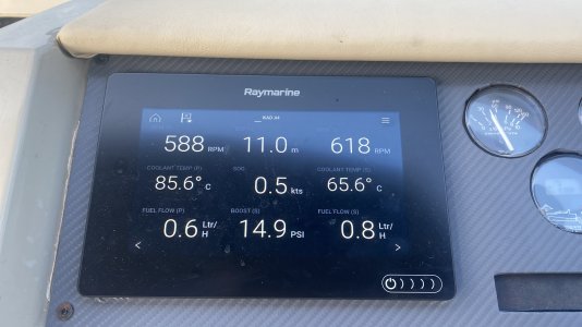

Hi All,
Still trying to sort an overheat on my KAD44….
Question, At idle in the marina what is considered normal ?
(I’ve had different opinions from two engineers, one says 40C is normal and one says 87C is normal)

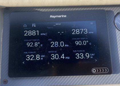

1) heating up to around 40/45 C and staying there until she’s out and opened up. (Starboard engine) which then holds around 90 C at 2700-3000 RPM
2) climbing up to 87 C at tick-over. This engine then runs at 93 at 2700-3000 RPM (port engine) - this is after a circulation pump failure and some leaks following an overheat (caught fairly quickly)
Appreciate any observations. You can see here the temp at 2800 RPM and then after waiting in the bay for permission to enter the harbour how the starboard engine cools much faster

The temperature in he marina is not helpful. The temp under load and running is. Is you got water tank connected to the port engine? That will keep it warmer for longer. First I would get an infra red thermometer and point it at the thermostat housings and see what temperatures that reveals. Cheap on Amazon etc. Then I would looking at cleaning out the cooling system with rydlyme.

Thanks for the reply - reason i mention the idle temp is that they’ve always held at 40/45 in the marina, even with some revs on. So me it was telling me something had changed with freshwater circuit since the pump failure
Which part of the system would you clean ? Fresh / Salt or both ?
Thanks again !
