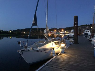

Maryport in Cumbria. The chap I bought her off got her from Scotland I believe.
Other than a broken bottom rudder bracket she's been great, even with the sometimes hefty weather the solway firth throws at her.

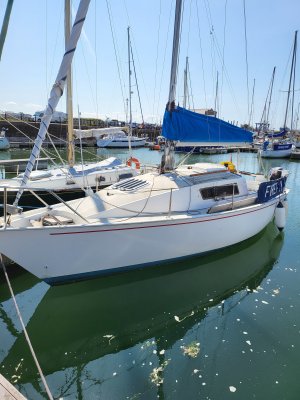

She was a fine boat, not the quickest in the world but would get you there quite safely, and in reasonable comfort. Here she is in Kirkcudbright!
