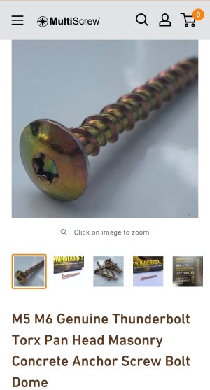

Jabsco twist and lock issue sorted. Need a screw!
Well, Jabsco call these screws self tapping screws, but no doubt you know better. 🙄
Definitely self tappers, when you buy the pump housing there is no thread in the plastic and they're a bugger to screw in the first time. Most don't buy just the pump housing though, it's cheaper to buy the full unit.
On the manual loo it's the same screw that's used into the collar around the joker valve .. #31, 6 off in the parts list.
I just installed one and uninstalled another and these are definitely different screws in at least some manual toilets. From memory the joker assembly ones were longer. I can't remember whether it was the old loo or the new loo but would make sense that they standardised over time.
They may well do - I am not responsible for the display of their ignorance. Just look at the picture and compare with a proper self tapper. Then buy a new base unit and note the thread already moulded in together with the notch to take the first part of the thread and the plain end to the screw. A self tapper cuts its own thread into the correct size plain pilot hole. Very different.

OK I am obviously out of date because last time I did this job (many years ago) there were threads in base.
Apologies to Jabsco as well!
And I still can't recall if I have two different lengths of those (two different thread height) screws in my toilet spares box on board...
Is there a name for screws with the two different height threads alternating?
They look very much like threads in a masonry screw :/
