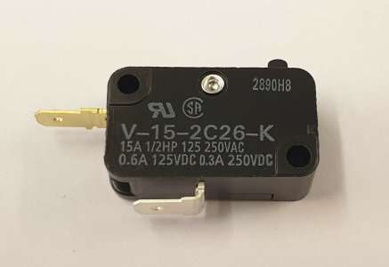

have replaced several of these over the years, although when they fail the pump either will not shut off pressurisng the calorifier or refuses to turn on.
Cost pennies (off Ebay) simple to replace, sometimes with the pump in situ.
