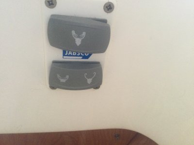

Can anyone tell me why I have two buttons to use the loo. I know jabsco it is a sealine.

The big switch opens the fill valve and runs the macerator together. The smaller one fills the toilet if pressed to the left and empties it if pressed to the right.

Hi Paul had the boat 7 years , I know what they do but I don’t understand why there are two flushing buttons.
Big one fills and empties.
Little one has separate options for fill and empty. Typically, you'd press the left side to pus some water in the pan, then when finished press the right side to flush it away.

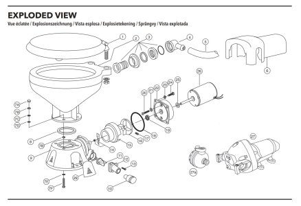

I've just serviced the "quiet flush" unit. For anyone undertaking this task, Jabsco sell a service kit but rather frustratingly, they used a 3/32" allen screw to hold the impeller on the motor shaft (part 17 in the diagram). All the tools on the boat are metric so needed a trip home to dig out my old imperial allen set.

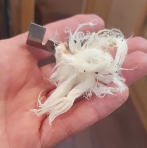

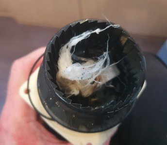

The loo has never really worked as expected since we owned the boat. Now I know why. Some man made fibres (looks like bit of old rope) was tangled around the macerator blade. All sorted now and the loo is fit to handle anything the local curry shop could throw at it.
