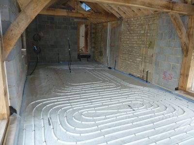

15mm Speedfit pipe has a min bend radius of 175mm (about 7 inches) without using formers. This isn't practical getting around a boat, particularly if it's a refit rather than a shell.
If you've ever fitted underfloor heating, you'll know what I mean.

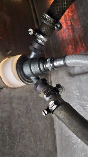

The shower has no tails to speak of - photos attached. As the boat is still in commission, I may do sections at a time and just isolate the showers until I disassemble the fitting to see how it works. The photo suggests the mixer has a male threaded part on the body.
