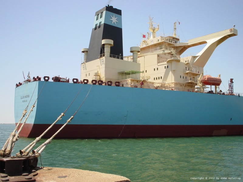

On a big ship, once the vessel is in the correct position alongside, the ship is fully secured by additional warps, so that there are 2 headropes / 2 sternropes/ 2 breastropes fwd and aft, 2 springs fwd and aft. This is "doubling up".
"Singling up" is the reverse process, so that there is only one of each rope ashore, and is the first part of getting ready for departure They may be slip-ropes as you show, if there is no one to slip the lines from the dockside.

The Fore and Aft Mooring parties will "single up" lines to Masters orders and Pilots advice .... it is to reduce lines to minimum safe to maintain vessel immediately prior to letting go. The lines kept / released could be any combination as decided by Master / Pilots advice taking into account whether shore uses fixed bollards, quick-release hooks etc. and of course use of tugs, current, wind etc.
No Merchant ship of any reasonable size would ever have a "slip-rope" as OP shows ... How ?
Further that nothing else happens until each party's officer reports back to Master that they are "singled up".
