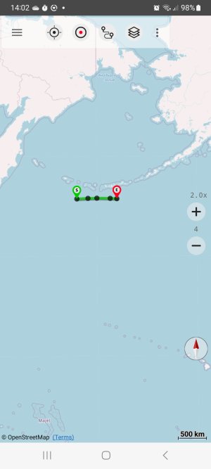

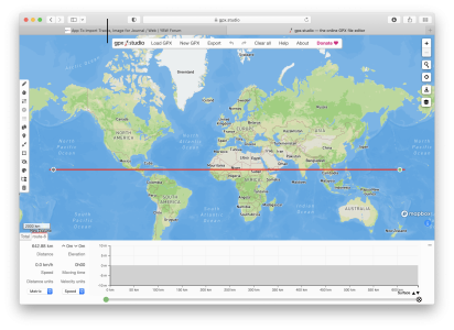

See here: gpx studio gets it completely wrong if it has the wrap at 180, it can't even render the latitude correctly!Screenshot 2024-02-05 at 15.16.04.png

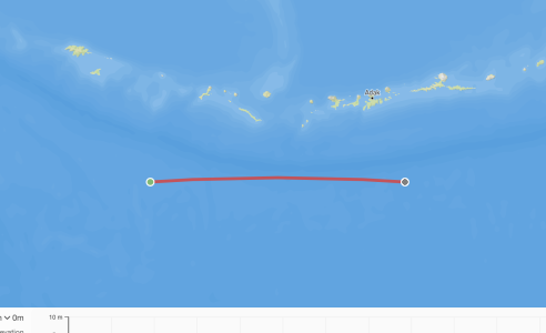

But with the manual edit it does:
MemoryMap gets it wrong, but at least the Latitudes are correct:
But a random app on my smartphone (Spain Topo Maps) gets it correct from the get go!
