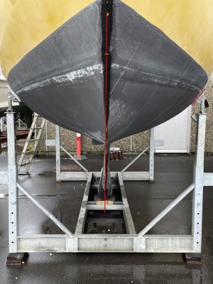

Want to buy my first boat, and there is a Rethana 27, good price, one year on shore. Not perfect, but decent.
I have noticed that her keel is a bit sideways 🙄 and I have no idea if this is something to worry about?

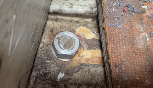

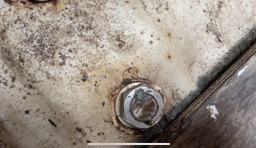

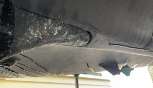

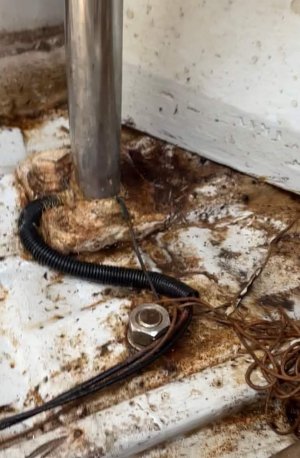

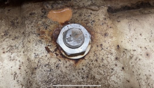

Very hard to tell from a wonky photo, but I'd be measuring that before proceeding - it certainly looks wonky in the photo. Combine that with new studs, different amounts of fouling between keel and hull next to it, and no (visible) sealant at the hull/ keel joint and (as @MoodySabre says) I'd be asking some serious questions.

You have shown photos of the keel bolts and studs which are obviously new. Were they replaced following a repair? You need to find out why Before spending any money on a survey. No good answers - walk away.
They say “current owner did not do any repairrs (in the last 4 years)… seems sketchy
4 people spent a lot of time walking around from all angles- it is not in center for sure… thank you for reply. It is not only me being “over suspicious”. I will step away from this boat

My previous boat, a Jaguar 27 was like that but more accentuated. It did go better on one tack though, but I don't remember which one! Never had any problems with it and the surveyor didn't notice it when I bought it. The new owner didn't either even though it was ashore at the time. I suspect it was like it from new, no evidence of it moving - is the keel machined flat before fitting? - I very much doubt it...
