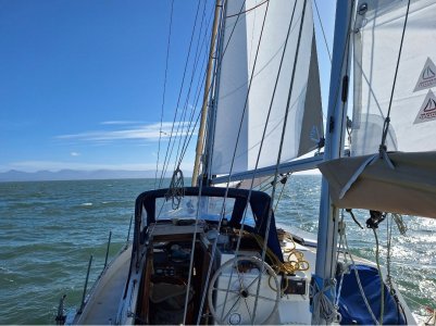

I agree about the starboard tack thing, although its only an issue for me in strong winds when reducing sail and not wanting to tack - it furls fine on either tack or head to wind in normal conditions. Again with a ketch rig, I will furl away some main early to a well reefed size or altogether, adding reductions to headsail and mizzen as needed. The mizzen is slab reefed.
For cruising singlehanded it is really nice to make sails disappear in an instant and concentrate on pilotage.Screenshot_20260309_155751_Gallery.jpg
