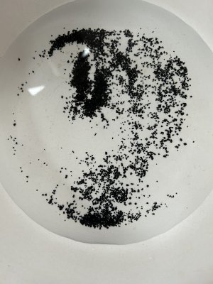

Good morning.
Have any other members had an issue with their in line fresh water filter depositing its charcoal from the inlet end into the fw pipework?
We have the filter fitted just under the sink and have used the same well known brand of filters (changed annually !!) for years. This season we have had 3 filters behaving in this way which means having to strip the other cold water taps each time as the charcoal granules travel through the syslem and block the lines.
Chatting to another yachtsman revealed that he had the same problem with three purchases (all from different chandlers).
The manufacturer when contacted about this were uninterested and told us to exchange via the retailer…
Buy a 10" clear filter housing and carbon block filter to fit. A fraction of the price of inline filters and twice the size as least. Lots more performance the bigger it is.
This. Better yet, fit it with a carbon block filter, which will also stops cysts, such as gardia. Unless the water is constantly chlorinated, like home, granular carbon is mostly a growth media for bacteria. The Pentex floplus 10 is a good one.

Thanks to everyone for the input. The solid block carbon does seem the way to go. Doulton appear to do a nice unit the filters are a reasonable cost and less than the aquafilter ones we have discarded.
