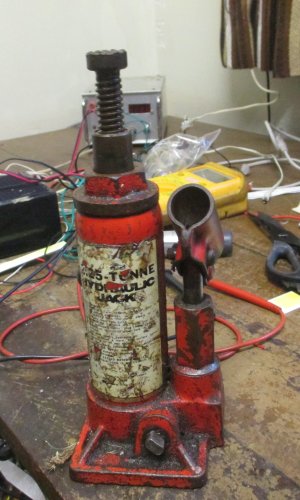

Went to jack the boat on trailer and found this jack would not rise. Operate the lever and it rises then falls back. Have filled the oil reservoir and the needle valve to release pressure looks OK. (and is screwed in tight) So many clever people on this forum. Has anyone any experience of dismantling this kind of jack. (or is it a throw away). Seems to be a hex on top of pump. A hex on top of cylinder and possibly the body screwed in to base. Where to start. I presume there is a non return valve some where inside. Thanks in anticipation ol'willjack.JPGjack.JPG

Went to jack the boat on trailer and found this jack would not rise. Operate the lever and it rises then falls back. Have filled the oil reservoir and the needle valve to release pressure looks OK. (and is screwed in tight) So many clever people on this forum. Has anyone any experience of dismantling this kind of jack. (or is it a throw away). Seems to be a hex on top of pump. A hex on top of cylinder and possibly the body screwed in to base. Where to start. I presume there is a non return valve some where inside. Thanks in anticipation ol'willView attachment 176376View attachment 176376

The problem is not that it will suddenly drop (the screw valve stops that).
The problem is a fail safe and will not raise.
Exactly the same system on a trolley jack.
The seals are under the hex fitting.

I disagree. If a knackered old seal fails completely it will drop very quickly.
Looks to me that the piston has rusted which will distort the top seal but if its not leaking oil its problem will be the non-return valve in the pump or the release screw seal cone damaged
I have several up to 50 ton of the same type from China and are easy to repair. If you don't wish to send it to me I I will fix it

Back to the jack: You could disassemble it, get both the pistons reground, hard chrome plated and finish ground, then reassemble with new seals... But it still won't work because the fault is indeed in either the non-return valve or the screw-in needle valve ;0) As you live in Asia this might be worthwhile to address, but over here, I'd just buy a new one.

Thanks again. Yes a new jack would be cheaper. However for the purposes I use them scissor type mechanical jacks with a much greater range of lift. Mostly this request came out of stubbornness of loving old tools.
Anyway I did open it up. The top hex takes off the reservoir and outer casing with pressure down to hold the seal of the body to the base. All looked ok. The hex on the pump cylinder also came off OK. Found huge amount of sludge and debris seemed to be sitting on top of a filter screen. Cleaned it out and reassembled with new oil and found the same effect still. Put it aside for another attempt another day.
However I remember my Dad saying you never clean brake hydraulics in kerosene/petrol as it damages rubber parts. I thought he said use methylated spirits but I found in this jack case metho dissolved nothing. Might have well used water. Any suggestions. ol'will

It contains C6-C7 hydrocarbons, (e.g. hexane)
Personally, I'd use parts washer fluid, the one which is largely kerosene, just not letting the seals sit in it for ages. Jack oil is a mineral oil after all.
