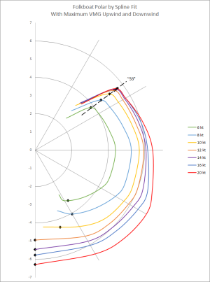

It's purely an idle thought along the lines of my Folkboat reaches its max, a nominal 5kts in about 15kts of wind. Anything over that just increased the heel really. My (as yet unsailed) GK24 will reach its flat water max in a lower wind speed I reckon, but as I state it's a notional thought as I've no experience of the boat.
As I wrote this, I came across this.
