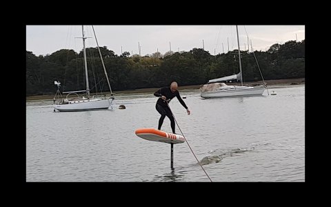

I'm towing this foil board at a whole 4 knts..

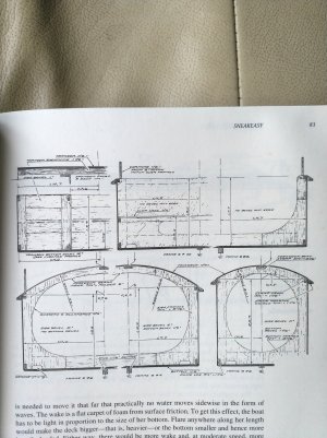

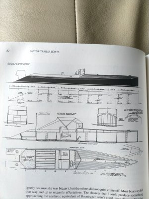

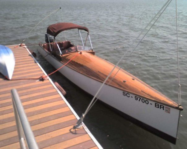

This is the hull form Phil Bolger developed for cheap-to-build powerboats that would run fast on low power. This particular example is 25' long and built with a gorgeous vintage finish so wouldn't suit the OP's needs but I do think that something along these lines, scaled down to fit, would be very suitable. The hull is a flat-bottomed plywood box, with just a little rocker forwards to bring the hull bottom clear of the water at the bow.
That is, indeed, a thing of remarkable beauty.
I wonder if a half-size version could be arranged, perhaps a tad beamier for stability, but keeping the slender form and the crew weight low and central, canoe-style.
Despite dozens of daydreams I've never even built a pram dinghy. Is it possible for a DIY shed-worker to make something so sleek and efficient-looking, just with sheets of ply?
Bolger's designs for simple home-built boats are remarkably simple and neat (he also designed amazing bigger boats for professionals to build). I built his June Bug design, a 14' plywood rowing/sailing boat, in 25 hours, not counting painting.
Here are a couple of pics from the plans for that boat - it's just a set of simple, rectangular frames with plywood wrapped around them. Your boat could be 6mm ply; the frames could be ply with thin softwood battens on the edges to get the fastenings into. I would build it with external chines, ie make the frames; fasten on the sides; glue and screw battens along the lower edge of the sides on the outside, then glue and screw the bottom onto the chines. I reckon two people could have something looking like a boat in an easy weekend. But I'd build it pretty quick and rough and see how it went under power before devoting any time to fine paintwork and finishing details...
