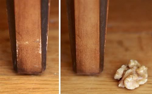

Old trick.
Slice a walnut and rub it onto the scratch (not a gouge, chip or dent) and photos of results please.
This almost looks too good to be true. :cool:
Definitely going to give this a go.
Should it fail, I'll try a scratch cover or wax stick.
