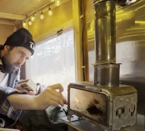

I found a Youtube channel in which a chap rides a bicycle across the chilly Minnesota countryside towing a rough wooden 'cabin' on wheels, with his dog. Pleasant quiet rustic wandering in an unpopulated area - nobody objects to him stopping, cutting fallen wood for his campfire and settling down for another night in the cabin.
But most interestingly (given how cold the weather is there) the chap has a very effective woodstove about the size of a domestic toaster, inside the cabin.
It has a flue and seems to operate without setting the cabin alight, and it made me think how welcome the warmth and simplicity of such a hot-box might be in a small yacht.
Does one simply get busy with welding gear and plate steel and make one, or are such things for sale somewhere?

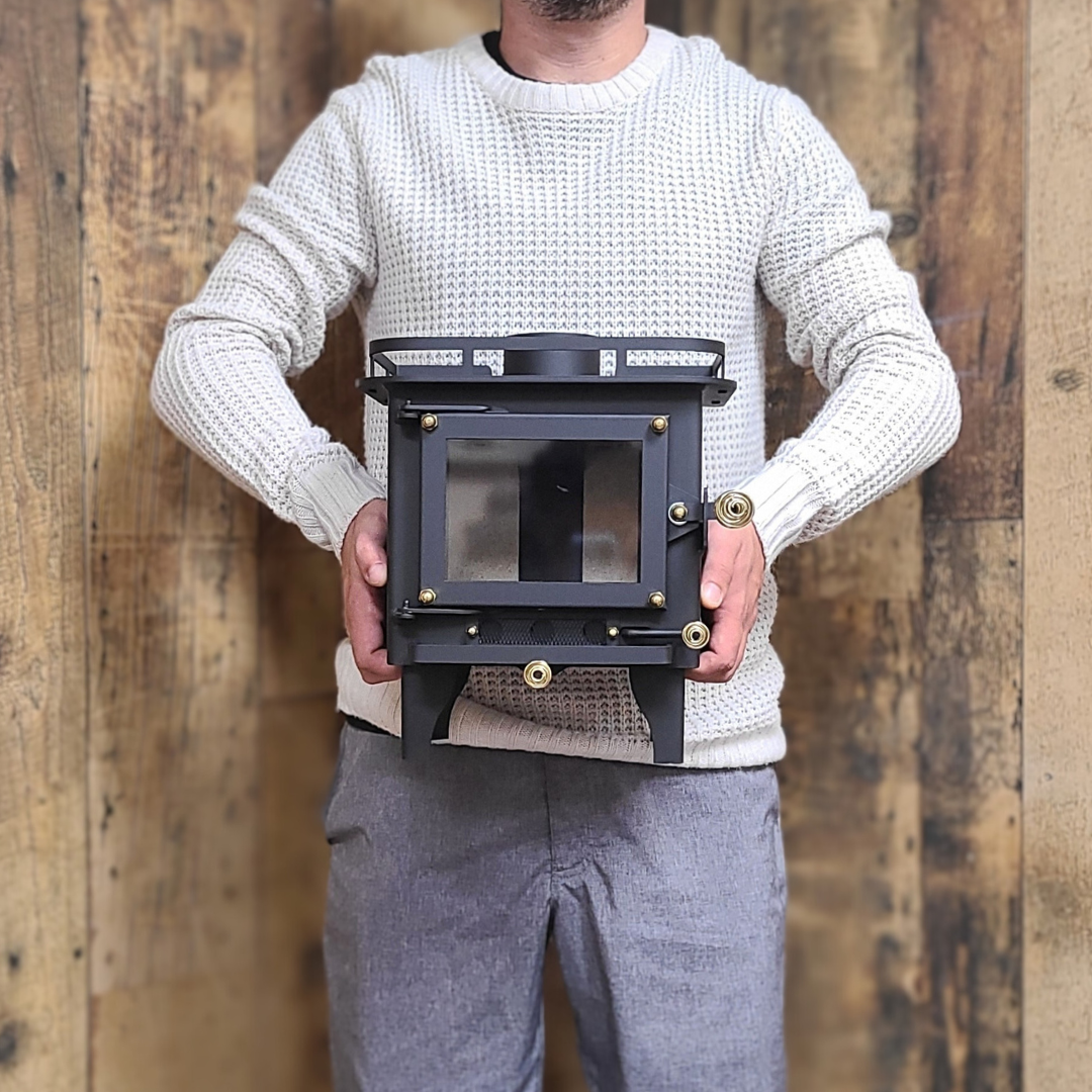

Well, you could make a really, really tiny one easily enough, but it wouldn't put out enough heat to be worth the bother.
There used to be quite small ones commercially produced, such as the (Atkey?) Pansy and one by Bengco (both bulkhead mounted). The latter was stainless steel IIRC, about maybe four inches square looking down on the top of it, and perhaps something like 14" tall, with the bottom three inches taken up by the ash pan/fire lighter. I've never seen a Pansy in the flesh, but imagine it to be slightly smaller. (I've read that the narrow chimney of the Pansy made the stove a little difficult to get, and could be overcome by warming the chimney with a blowtorch or similar.)
