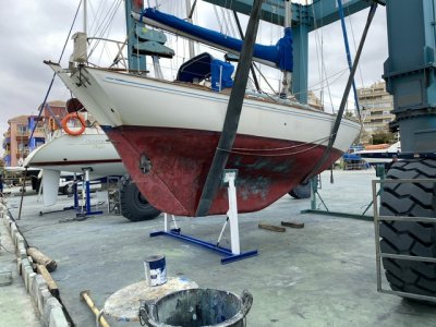

Look at your lower photo graph, and think what will happen if that forward sling should start sliding up the curve of the hull towards the bow.
There is nothing to constrain the bottom of that sling moving forward, because the point of attachment of the sling is high above the hull - the sling itself would just as happy at say 45 degrees to the vertical.

Nor me. That arrangement must enable the slings to be as near as possible to 90 degrees to the surface they bear on, which must be best in every way mechanically. We’ll be lifting much of the Yarmouth XOD fleet in a few weeks. That is done with a crane, the slings naturally angle themselves with a single point of attachment. For those without their own strops that is.
Tying them together just above deck height doesn't stop them being vertical (or 90 degrees as you put it), but it does stop them sliding up the curve and becoming non-vertical.
You and Refueler may not have seen (or perhaps noticed) it. But I have.
I've also seen it not done, and nearly lost my boat to it on one occasion. I'm sure you'll find other examples of its absence, too, among the 'boat lifting fails' on the internet.
Depends on the boat and crane. In this case they couldn’t get the straps close enough for comfort so tied the strops together. I normally insist on it. IMG_6176.jpeg
